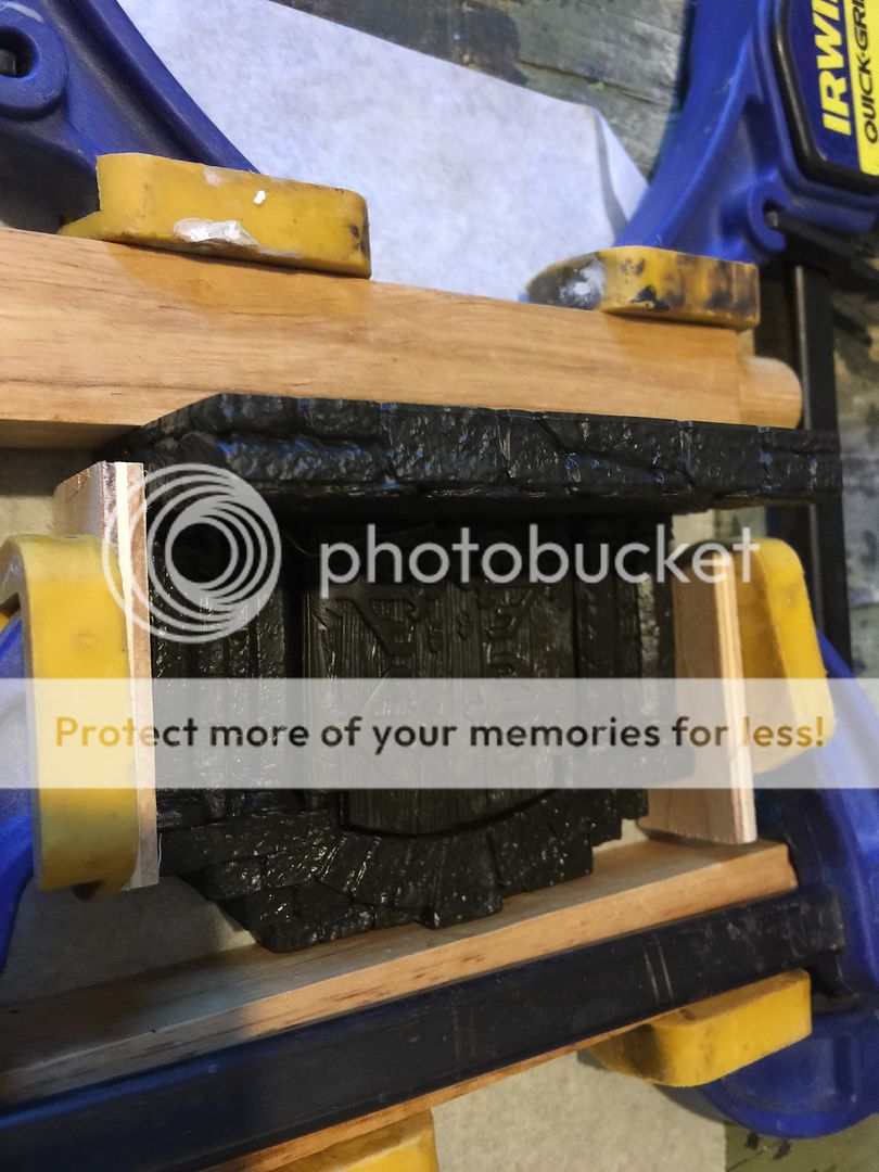

It will be difficult to dewarp parts without clamps Plastic has a certain amount of elasticity but if you heat it you may reset it.If the part sat in the heat with pressure on it, the warped shape is probably the set point.
You need to warm it up and reset it to shape.
This part had to be clamped in several directions to square it up. Note the wood spacers to protect the plastic from maring.

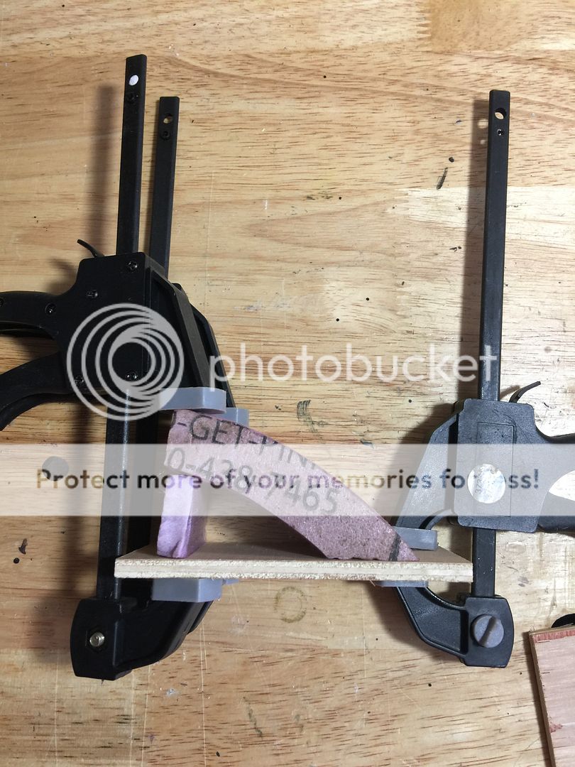

I made a bridge shape to illustrate the directions to clamp the bridge.
The base and the height block are important. The base block will keep it square. The Height spacer block is necessary for the correct shape. Shape it warm then pour tap water over it to reset the plastic.
Reshaping a bones sword is not hard. Something like the bridge takes more experience. You can do it.
