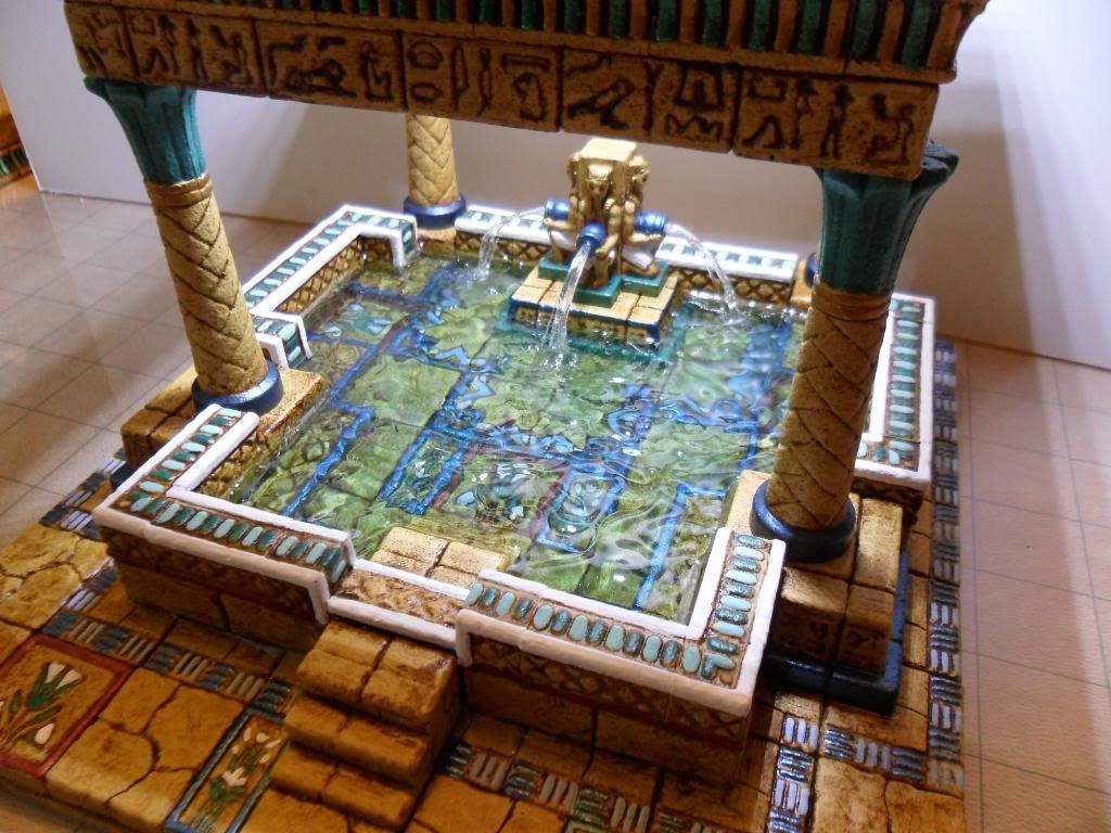

I might have been too tired to notice it, but was Envirotex Lite and/or 2 part-epoxy mentioned for water effects? They are what I started on and I've loved the effects. I can't find the pictures, but I did some waterfall pieces with leftover Envirotex Lite on a partially crumpled plastic garbage bag. Wrinkle the bag then pour lines of Envirotex Lite along the lines of the wrinkles. Before it's fully set, (cured enough to hold it's texture but soft enough to bend) wearing gloves to prevent fingerprints, drape the pieces over your rocks. Add additional splashes using 2-part epoxy.
Here's one of my many fountains using the Envirotex Lite method explained on the Hirst Arts website.
