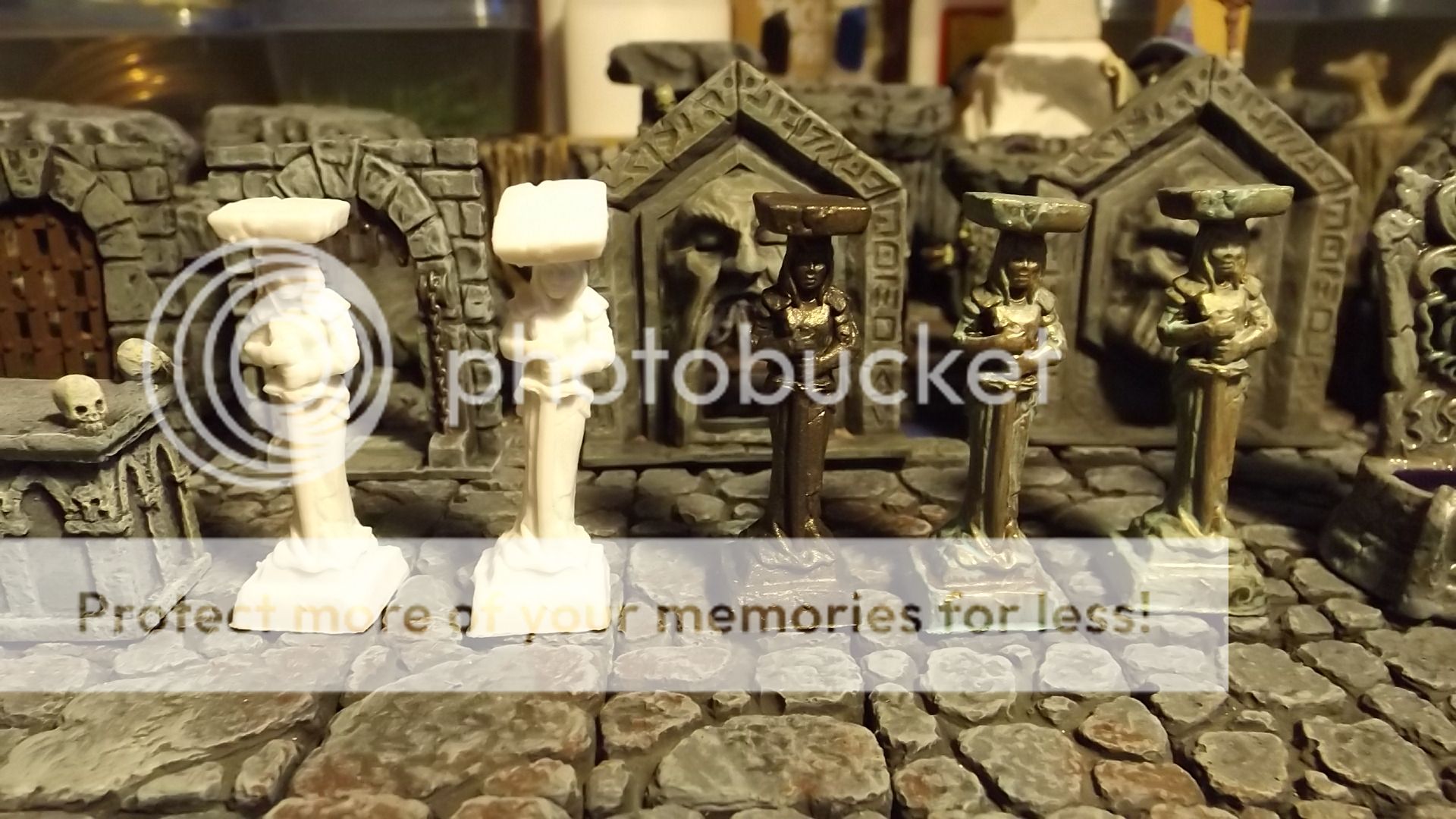

lostpict wrote:I have one painted Imperial and one Wargamer Street sets. About 6 straights were warped. I bent them back into shape with my hands. After two weeks only one has rewarped - I will tackle it with a heatgun. Good luck.
I want to caution everyone again about the heat gun. Even with a laser thermometer it is hard to heat the tile evenly. I like boiling water best. The one tile may be a better candidate for the oven. Preheat the oven to 200 F and set the timer for ten minutes. Make sure the pan is not warped. Remove the tile and let the tile cool on a flat surface. Gravity should help you out.
My set won't be here until Wednesday. I will lay them out flat for a few days and let them adjust and fix anything that is still a problem.
I like Hot water because it is easy to manipulate the part while its hot. A redo is much faster if it does not work the first time.
Something happened to the bones figure probably in shipping. It is hot in Texas. I ordered six more for a temple I am building. I am going to pant them to match the stone alter. I will make the adjustments at the same time so that the temple walls and columns will be square.
This is all a part of model building.
