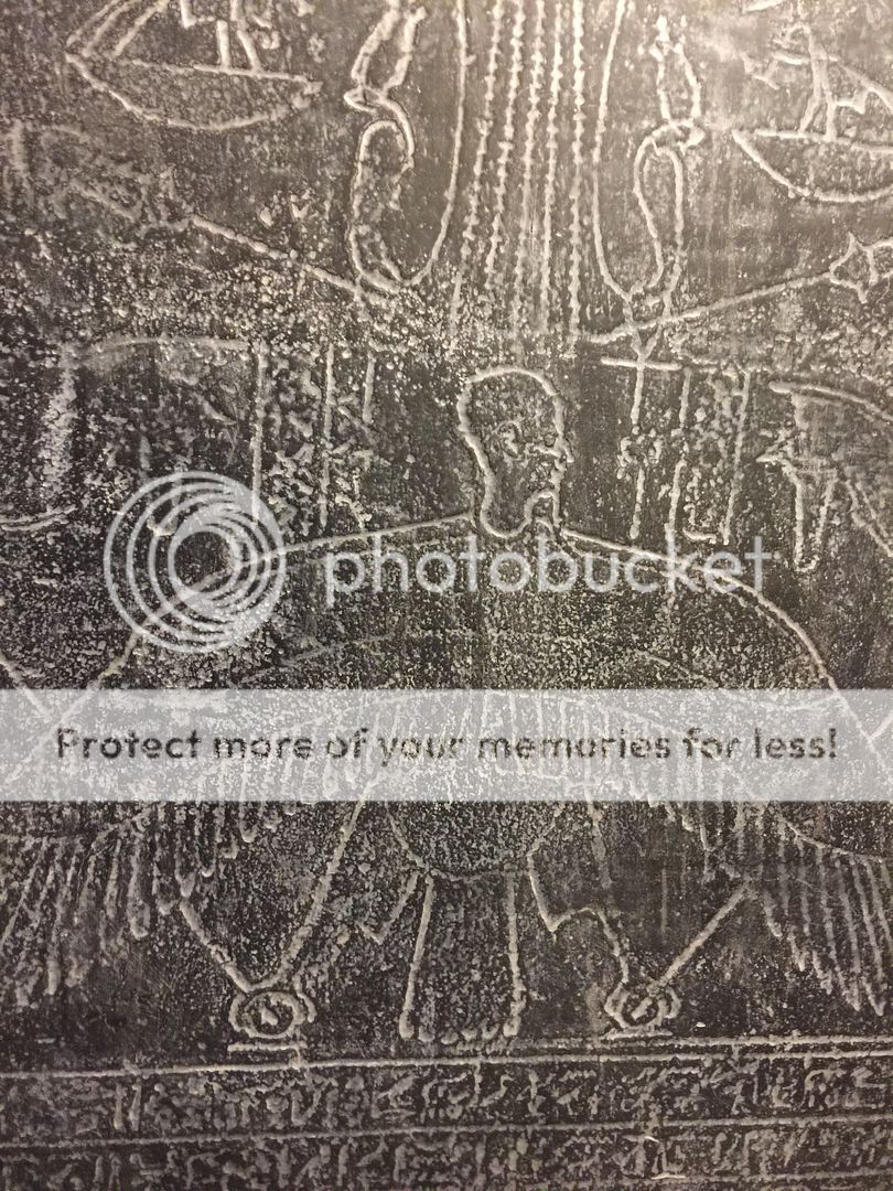

I did not have any trouble with the sound :D
I have used the shoe polish method with restorations.
I made this master from a antique cartridge paper egyptian rubbing for one of my old coworkers. I was concerned that latex rubber would destroy the original. I used a waterproof flat varnish to protect the paper and pourded the hydrocal into a plasticine frame. I used mold max over the master for a permanent mold so he could make as many as he needs.
I kept the master it is on the wall in the hall.
The finish is black shoe polish and talcum powder.
I have used the Army Painter Dip. I have and use the washes. I like the washes better.
I also use floor polish with Pokorny paints.
You can use matte medium if you want the wash to be flat.
